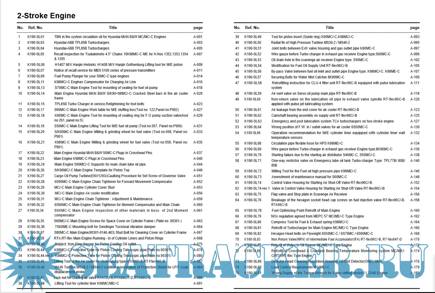

2-Stroke Engine -SL01TBN in the system circulation oil for Hyundai-MAN B&W MC/MC-C Engines
K190-SL03Hyundai-ABB TPL85B Turbochargers
K190-SL04Hyundai-ABB TPL85B Turbochargers
K190-SL05Recall inspection for Tsubakimoto 4.5" Chains 10K98MC-C ME for H.Nos.1352,1353,1354 & 1355
K190-SL06H1407 M/V Hanjin Helsinki, H1408 M/V Hanjin Gothenburg.Lifting tool for M/E piston
K190-SL07Notice of recall service for MBS 5100 series of pressure transmitters
K190-SL09Fuel Pump Plunger for your 50MC-C type engines

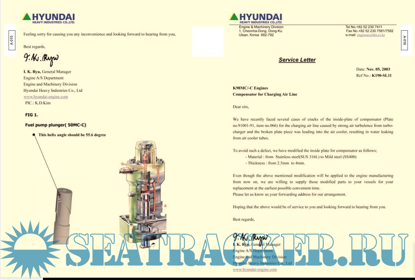

K190-SL11K98MC/-C Engines Compensator for Charging Air Line

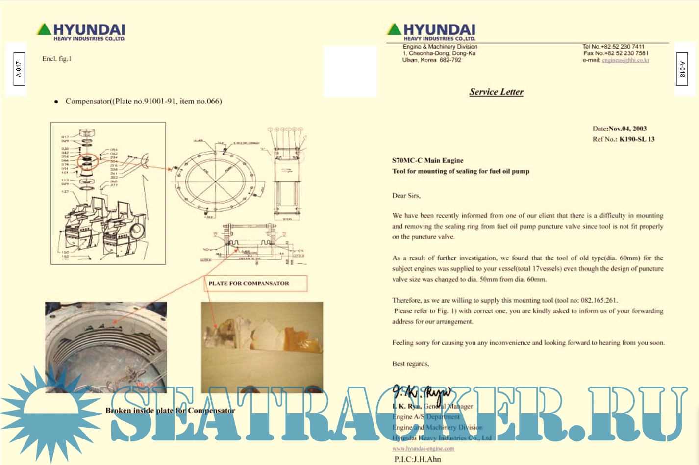

K190-SL13S70MC-C Main Engine Tool for mounting of sealing for fuel oil pump
K190-SL14Main Engine Hyundai MAN B&W S/K90+98MC/-C Cracked Steel bars in the air cooler frame
K190-SL15TPL85B Turbo Charger in service,Retightening for foot bolts
K190-SL17S90MC-C Main Engine Work table for M/E stuffing box(Tool no: 122,Panel no:P902)
K190-SL18K80MC-C Main Engine Tool for mounting of sealing ring for F.O pump suction valve(tool no:261, panel no:S)
K190-SL19S50MC-C Main Engine Lifting Tool for M/E fuel oil pump (Tool no:057, Panel no:P909)
K190-SL20S/K90MC-C Main Engine Milling & grinding wheel for fuel valve (Tool no:058, Panel no: P901)
K190-SL21K98MC-C Main Engine Milling & grinding wheel for fuel valve (Tool no:058, Panel no: P901)
K190-SL22Main Engine Hyundai MAN B&W 50MC-C Plugs in Crosshead Pins
K190-SL23Main Engine K98MC-C Plugs in Crosshead Pins
K190-SL24Main Engine S90MC/-C Supports for main chain lube oil pipe.
K190-SL26S/K90MC/-C Main Engine Template for Piston Top
K190-SL27Cargo Oil Pump Turbine(ENV120G)Caulking Procedure for Set Screw of Governor Valve
K190-SL286S90MC-C Main Engine Chain Tightener for Forward Movement Compensator
K190-SL29MC/-C Main Engine Cylinder Cover Stud
K190-SL30MC/-C Main Engine Air cooler modification
K190-SL31MC/-C Main Engine Chain Tightener : Adjustment & Maintenance
K190-SL326S90MC-C Main Engine Chain Tightener for Moment Compensator and Main Chain
K190-SL34S60MC-C Main Engine Inspection of other materials in boss of 2nd Moment compensator
K190-SL35S60MC/-C Main Engine Screws for Space Cover on Cylinder Frame ( Plate no. 90301-)
K190-SL367S60ME-C Mounting bolt for Geislinger Torsional vibration damper
K190-SL37S80MC-C Main Engine(90301-0146,483) Stud Bolt for Cleaning Cover on Cylinder Frame
K190-SL39RTA,RT-flex Main Engine Running - in of Cylinder Liners and Piston Rings
K190-SL40Subject; Non-Flow Sensor for Piston Cooling Oil outlet
K190-SL44K98MC/-C Protective Tube for Piston Cooling Telescopic pipe(Plate no.90301)
K190-SL44.rev.1K98MC/-C Protective Tube for Piston Cooling Telescopic pipe(Plate no.90301)
K190-SL45Lifting Tool of the Air cooler for Under slung type RTA96C-B,RT-Flex96C-B
K190-SL46MAIN Turbine;MS36-2 / MS40-2 Additional Installation of Protection Shield for LP/T Axial displacement probe
K190-SL47Lock nut for Starting air valve RTA72U-B,RTA84C/T-D,RTA96C/-B
K190-SL48Lifting Tool for cylinder liner K98MC/ME/-C
K190-SL49Tool for piston insert (Guide ring) K90MC/-C,K98MC/-C
K190-SL50Radial fin of High Pressure Turbine MS36-2 / MS40-2
K190-SL51Joint bolts between Exh' valve housing and gas outlet pipe K80MC-C
K190-SL52Wire gauze before Turbo-charger in exhaust gas receiver Engine type;S60MC-C
K190-SL53Oil drain hole in the scavenge air receiver Engine type; S50MC-C
K190-SL54Modification for Fuel Oil Supply Unit RT-flex96C/-B
K190-SL56By-pass Valve between fuel oil inlet and outlet pipe Engine type; K98MC/-C. K98ME-C
K190-SL57Securing Bolts for Water Mist Catcher 8K90MC-C
K190-SL58Retrofitting instruction for CLU-4 filter unit RT-flex96C-B equipped with pulse lubrication system
K190-SL59Air vent valve on Servo oil pump main pipe RT-flex96C-B
K190-SL60Non-return valve on the lubrication oil pipe to exhaust valve spindle RT-flex96C-B applied with pulse jet lubricating system
K190-SL61Air leakage from the end cover for air cooler RT-flex96C/-B
K190-SL62Camshaft bearing assembly on supply unit RT-flex96C/-B
K190-SL63Emergency and post lubrication system TCA turbochargers on two-stroke engine
K190-SL64Wrong position of F.W. in / outlet valves for air cooler 6S50MC-C
K190-SL66Operation recommendation for M/E cylinder liner equipped with cylinder liner wall temperature sensors.
K190-SL68Circulation pipe flexible hose for HPS K98ME/-C
K190-SL69Wire gauze before Turbo-charger in exhaust gas receiver Engine type;8K90MC-C
K190-SL70Starting failure due to the starting air distributor S46MC-C, S50MC/-C
K190-SL71One-way restrictor valve on Emergency lube oil tank Turbo-charger Type: TPL77B/ 80B/ 85B
K190-SL72Milling Tool for the Fuel oil high pressure pipe K98ME/-C
K190-SL73Amendment of maintenance manual for S60MC-C
K190-SL74Control Valve Housing for Starting Air Shut-Off Valve RT-flex96C/-B
K190-SL74-rev.1Valve in Control Valve Housing for Starting Air Shut-Off Valve RT-flex96C/-B
K190-SL75Flap valve and Stop plate in Scavenge Air Receiver
K190-SL76Breakage of the hexagon socket head cap screws on fuel injection valve RT-flex96C/-B, RTA96C/-B
K190-SL78Fuel Optimizing Point Retrofit of Main Engine
K190-SL79NOx regulation agreed from MEPC 57 MC/ME/-C Type Engine
K190-SL80Compress Tool for Fuel & Exhaust spring K98MC/-C
K190-SL81Retrofit of Turbocharger for Main Engine MC/ME/-C Type Engine
K190-SL82Hexagon Head bolts on Flyweight 6S50MC-C / 6S70MC / 6S90MC-C
K190-SL83Non Return Valve(NRV) of Intermediate Fuel Accumulator(IFA) RT-flex96C/-B, RT-flex84T-D
K190-SL87Retrofit of Water In Oil Sensor MC/ME/-C Type Engine
K190-SL88Retrofit of Crosshead & Crankpin Bearing Temperature Monitoring system MC/ME/C/RTA/RT-flex Type Engine
K190-SL89Detector Head Cleaning Procedure Graviner Oil Mist Detector(OMD) MK6
K190-SL90Load Control Requirements MC/ME/-C
K190-SL91Wrong Supply of the Torque Wrench for Valve setting device / L32/40 Engine

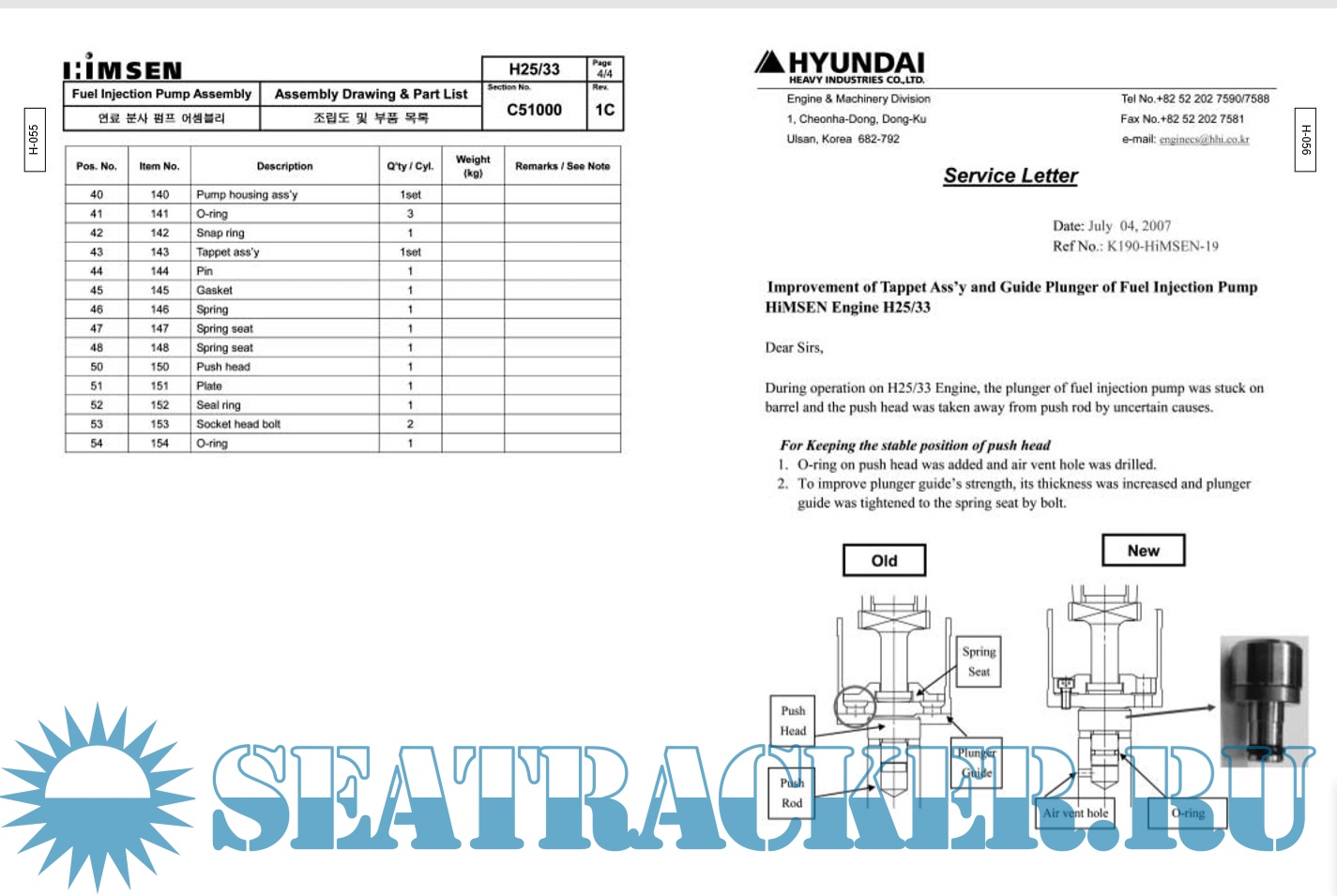

K190-HIMSEN-19Improvement of Tappet Ass'y and Guide Plunger of Fuel Injection Pump HiMSEN Engine H25/33
