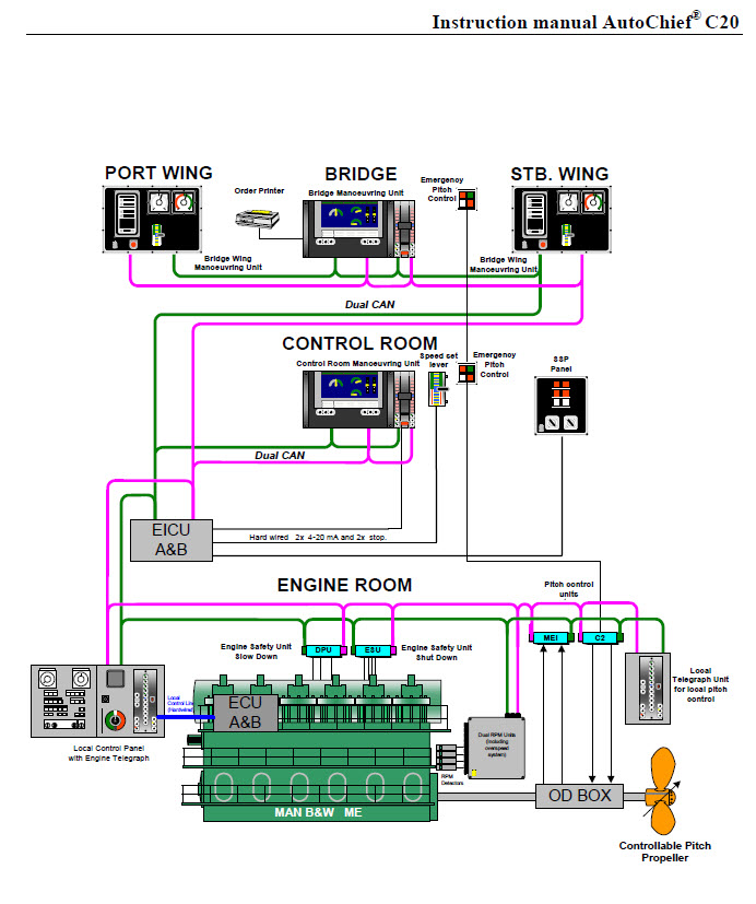

Instruction manual AutoChief® C20 FUNCTIONAL DESCRIPTION
Remote Control System Functional Description
The Kongsberg Maritime C20 Marine Automation system consists of, among others the AutoChief® C20 Propulsion
Control System. Modular design allows flexibility in configuring the system to individual requirements, covering the
whole range from standard propulsion configurations to highly advanced twin or quadruple engine installations with high,
medium or low speed engines connected to reduction, reversing gear or variable pitch propellers. This system may be a part of a total integrated ship control system consisting of other sub.
Systems such as:
• Alarm and monitoring system.
• Auxiliary control system.
• Power management system.
• Ballast automation system.
• HVAC (air conditioning).
• Management support
The system is based on Kongsberg Maritime unified automation concept, where each individual ship configuration is built up
using standard modules communicating on CAN- and local area networks. The C20 system is configurable for all ship types.
The AutoChief® C20 Propulsion Control System is designed for remote control of the main engine from the combined telegraph and manoeuvring lever in the wheelhouse. By moving this lever, the system will control the controllable pitch propeller and provide forward or reverse thrust as requested
