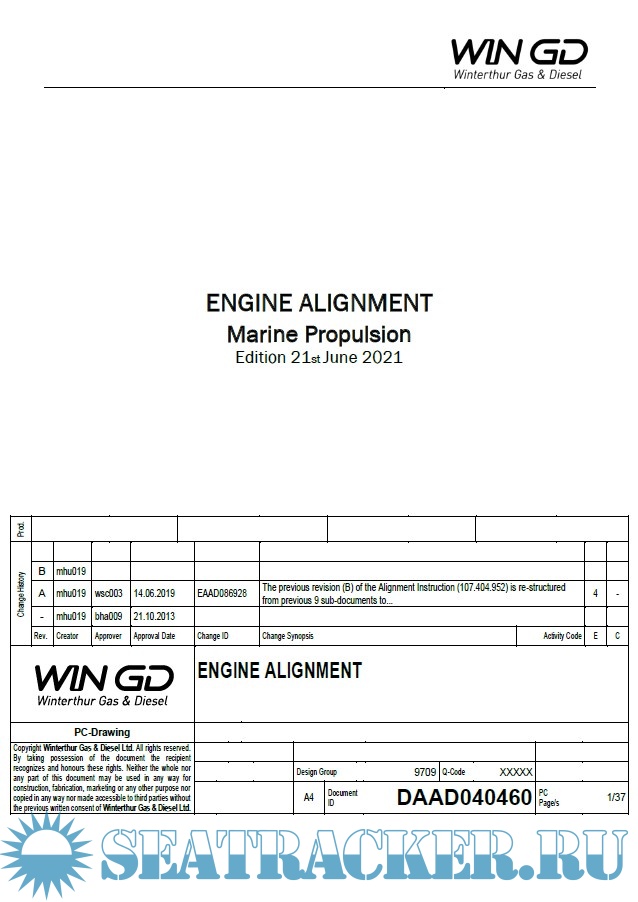

Engine Alignment - Marine Propulsion
Year: 2021
Author: Winterthur Gas and Diesel
Publisher: Winterthur Gas and Diesel
Pages count: 38
Description: The installation and alignment of the propulsion shafts and main engine are the responsibility of the shipyard. It shall ensure the following for all ship operating conditions:
1. static bearing loads within the limits
2. angular alignment of the propeller shaft inside the aft stern tube bearing bore within the limits
3. crank web deflections within the limits
To fulfil the above mentioned requirements, the factors having an influence on alignment need to be
considered adequately, like for instance operating forces and temperatures as well as elastic ship hull
bending.
The alignment of the propulsion shafts and main engine is carried out according to a case-specific
alignment layout calculation (ALC), and compliance with this is verified by measurements.
The WinGD alignment documentation contains:
1. instructions, providing limits and requirements to comply with
2. recommendations and guidelines, given for reference, to support
in achieving compliance with the requirements and limits
