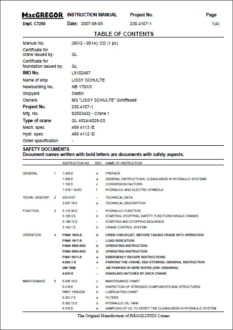

TABLE OF CONTENTS
GENERAL 1 1.005 E e PREFACE
1.009 E a GENERAL INSTRUCTIONS, CLEANLINESS IN HYDRAULIC SYSTEMS
1.102 E c CONVERSION FACTORS
1.518.1 SvED f HYDRAULIC AND ELECTRIC SYMBOLS
TECHN. DESCRIP. 2 230.4107 - TECHNICAL DATA
2.007.16 E a TECHNICAL DESCRIPTION
FUNCTION 3 3.110.34 E - HYDRAULIC FUNCTION
3.126.3 E b STARTING, STOPPING, SAFETY FUNCTIONS SINGLE CRANES
3.136.12 E - STARTING AND STOPPING SEQUENCE
3.142.1 E b CRANE CONTROL SYSTEM
OPERATION 4 PM40 1830-E b CREW CHECKLIST, BEFORE TAKING CRANE INTO OPERATION
PM40 1817-E - LOAD INDICATION
PM40 5500-E00 b OPERATING INSTRUCTION
PM40 6050-E00 b OPERATING INSTRUCTION
PM41 0011-E a EMERGENCY ESCAPE INSTRUCTIONS
4.620.1 E n PARKING THE CRANE, SEA STOWING, GENERAL INSTRUCTION
388 7888 - JIB PARKING IN WIRE ROPES (DIM. DRAWING)
4.630 E - HANDLING HATCHES BY DECK CRANE
MAINTENANCE 5 5.005.19 E c MAINTENANCE CHART
5.018 E b INSPECTION OF STRESSED COMPONENTS AND STRUCTURES
PM51 1355-E00 b LUBRICATING CHART
5.301.7 E a FILTERS
5.302.12 E b HYDRAULIC OIL TANK
5.315 E a SAMPLING OF OIL TO VERIFY THE CLEANLINESS IN HYDRAULIC SYSTEM

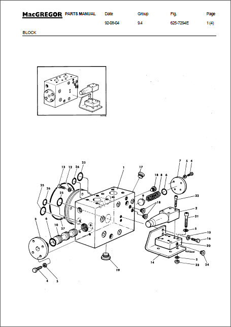

BLOCK 187 5228-801 Ul 625-7294E

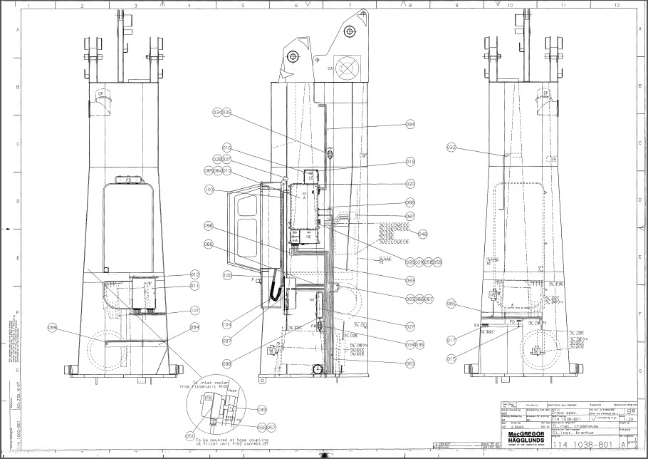

EL. INSTALLATION 114 1038-801 A/A 1141038

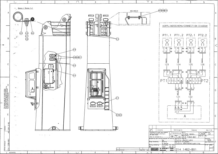

9.7 EXTRA DECKLIGHT 214 1462-801 -/- 214 1462

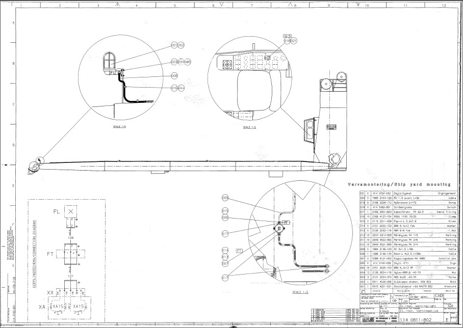

EL. INST. WARNING LIGHT; YARD MOUNT. 114 0811-802 Cl 114 0811
