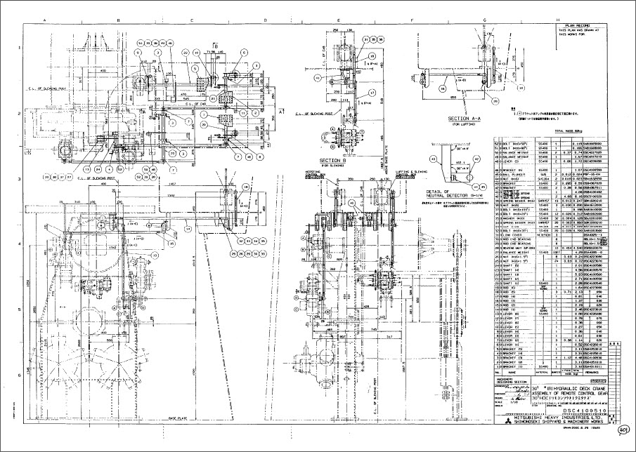

(10) Assembly of remote control gear DSC4100600

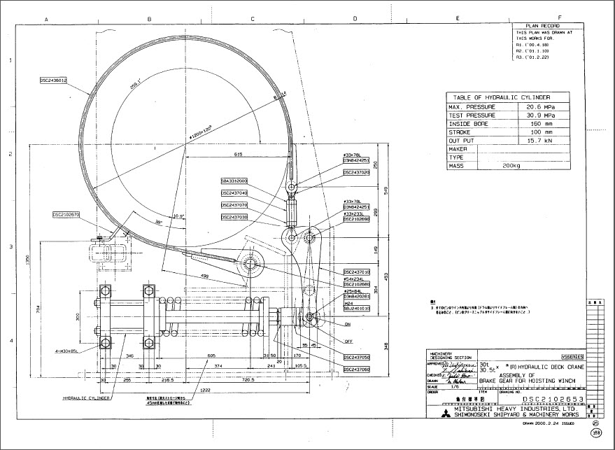

Hydraulic equipment

(a) RMC-350A-L(A) arrangement (for hoisting)
(b) MB350AS200BS091 Outline dwg. (for slewing device)
(c) MB350AS200BS091 Assembly dwg.
(d) MB350AS200BS091+CW300BAS219 Outline dwg.
(for luffing device)
(e) MB350AS200BS091 Assembly dwg.
(5) Oil cooler (39000 Kcal/Hr) (1223-042-533) DSC2102721
(6) Assembly drawing of hydraulic cylinder (for hoisting) DSC2102130
ME3500-122-0 8 DSC2102510
DSC2102521
